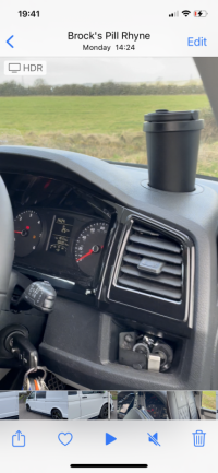

I had a auto electrician come fit the halo9, I bought the t6 wiring kit and he fitted it, he did have a lot of head scratching and I didn’t have mfsw at the time, I’m not sure it’s wired up as meant to be, radio and dab signal rubbish since fitting, iv added pic of clocks and mfsw that’s fitted.
All controls work on left mfsw control,
Right controls
Talk button = mutes radio,
Left right silver part (think it’s scroll) goes through mpg/miles left etc,
Left/right on bottom of right switch pack scans radio station.
Phone button can only answer and hang up when incoming, can’t call out, no scroll through phone book.
