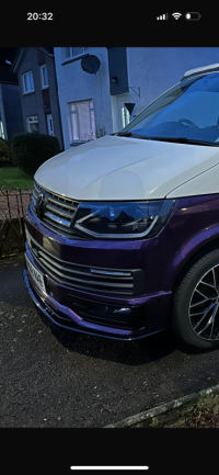

I just bought as per the pic and they came with everything I needed from Elliot, I did have along conversation with him a couple of times just to make sure I was getting everything I needed, there was a couple of bit missing and a mix up that did hold me up but I must admit Elliot at Travelin lite did get it to me asap with out question and no extra cost and he was available for advice as he has fitted the all the stuff himself and it was him that did the instructions.
If you are doing this your self let me know and ill give you my number just in case you get any issues as I fitted all mine myself or with one other for support tbh. Now that I've done it, it is pretty straight forward.

Hi Willie
My bumpers are the same travelin lite ones, they are away getting sprayed at the moment, I have looked at the old front startline bumper and it has a strengthener inside at both ends, a kind of criss-cross section, did you transfer this onto the new front bumper before fitting, or is it not needed? Thanks
