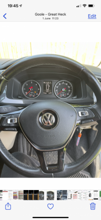

I’d totally recommend @Dav-Tec who's based in Nottinghamshire, but it depends where you are and if you’re willing to travel?Just picked this wheel up.. hoping to get fitted and coded to my ‘17 T6. Think mine is a startline? It has a basic MFD. Has
the front radar for emergency braking but no cruise control yet.
Anyone able to help fit this? I also bought this wiring kit from kuafatek.
Cheers
View attachment 125343View attachment 125344

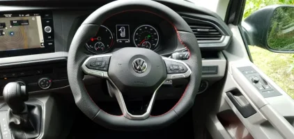

That wheel is for ACC so the electronics won’t work on your car and will cause errors. To use that wheel you will need to swap out your old electronics from your old wheel.
He will need an airbag as well at the T6 airbags are fir different mounts than that wheel.That wheel is for ACC so the electronics won’t work on your car and will cause errors. To use that wheel you will need to swap out your old electronics from your old wheel.
Whats that from? It looks like a newish one as it has the new VW badge. In that case I am going to say no, wont work.
Thats golf 8 passat b8 t6.1 etc steering wheelWhats that from? It looks like a newish one as it has the new VW badge. In that case I am going to say no, wont work.
You need to use PQ to MQB converter.Thats golf 8 passat b8 t6.1 etc steering wheel
