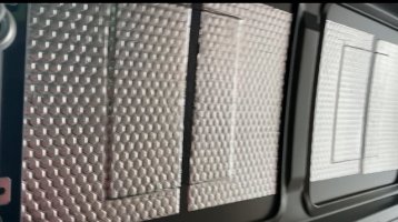

With 3 bank holidays this month, I couldn’t put off starting the van interior any longer. We’re keeping it as a kombi day van and plan to keep the inside as factory look as possible (so no carpet lining}. Ordered Medium Van Kit plus a bit more stuff from DodoMat, v prompt delivery. Also their trim removal tool set and roller (v useful) and panel popper (still haven’t used it). With time and practice, have only broken 1 panel clip so far.
- Sound deadening with Dodo Deaden Hex Mat ~ aiming for 75% coverage per panel (this stuff is heavy and expensive!). Don't think I will use all the Hex mat provided…

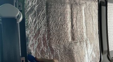

- Insulation layer 1 with Themoliner v3 6mm. On ALL the surfaces that will be under panels
- Insulation layer 2 with B&Q Diall recycled bottle insulation. V satisfying to stuff but doesn’t go as far as I thought.
Have proceeded by location, rear side panels both done, made a start on the tailgate this weekend. Can I insulate inside the seat belt pillars and other stealh locations? Still unsure but tempted to try…
