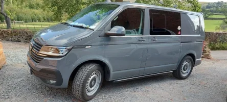

I have amaroks with general grabber at3s IMG_5563.JPG20200912_154314.jpg235/55/18 and 235/60/18. I tested 255/55 and although they went round they snagged when the suspension was compressed on lock. Too big for unhindered use on standard suspension.

Thanks for posting that, much appreciated. I don't suppose you have any photos of your van showing it side on?

I've just got the S+S 18" steelies on my van. Really pleased so far, although haven't managed a long run on them yet!
Tyres are General Grabber AT3 235/55/18.
They look and feel really tough, which is what I was looking for, with the state of our roads these days!
Dropped the suspension 40mm on H & R springs too. I think the van sits nicely and the ride has definitely improved.
I get minor rubbing on the wheel arch on full lock but not enough to worry about.
