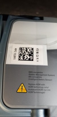

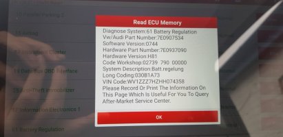

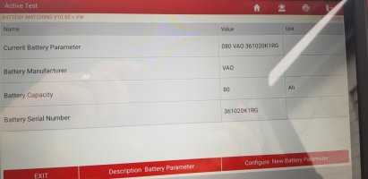

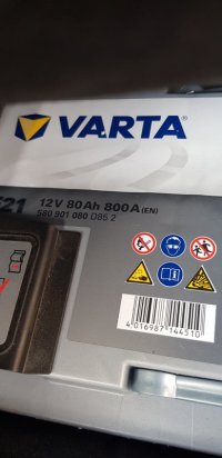

I replaced my original OEM Varta AGM battery 12 V 75AH with a new Varta F21 12V 80 AH AGM.
My mate had a go at coding it but we had trouble with the F21 serial number. So Google said use the old serial number and change the last digit. Is that okay to do?
