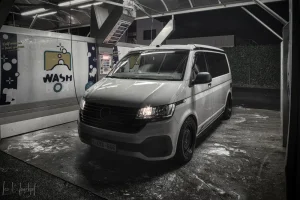

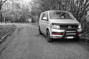

dirty vs clean
kw coilover , front lowest setting , rear sits a bit higher , light nose down, when loaded to go camping she sits level.
banded amarok's 8,5J all around
general grabber at3 235/55 18
sliding door, catches the rear tyre, slight.
front rubbs the arches when going over some speedbumps, might raise the front 5mm or so
