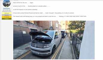

but i would say that at some point you will end up with a flat starter battery.
so either make sure you have some beakdown cover like AA or RAC etc.
or even better - get yourself a jump pack so you can jump start your own van without 3rd party help.
they are well worth investment to help stop you getting stuck.
more on that here:
www.t6forum.com
more on that here:
Which Jump Starter?
Advice required. Hi guys - I thought it would be prudent to carry one of those small JumpStarter powerpacks about with me as I have an electric lift seat installed for my better half and am a little concerned that with the extra demands on the van battery I might get caught out one wintery...
