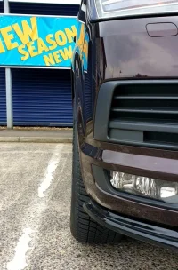

Another option for T32 is the BBS SX wheels.
Was going to get some Wolfrace X10x, but there was a stock issue with the seller.
So looked elsewhere.
On rimstyle.com you can enter T32 as vehicle type and it'll only show correct load rated wheels.
Ordered them in 18x8 as they also state they do compatibllity check on all orders before dispatch as well.
For peace of mind I also emailed them for confirmation. Had a swift response:
Great service so far.
Will double check wheel stamp when they arrive. But am looking forward to getting tyres sorted and fitting them.
Cheers
