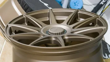

I will need four new tyres very soon - which leads me to think of a wheel change...
I like these, and they are weight rated for my T32. My van is blackberry and I like the idea of bronze wheels on the van. But then I keep getting distracted by the gloss gunmetal... Do matt finishes demand more car/looking after? Does anyone have any experience of these wheels? How does the Central cap secure? I am going to stick with 8.5x18" size.
