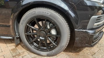

Running 235/55/18's (Michelin Cross Climate 2's) on mine with 1 Form Edition 3 wheels. Tyres seem a good compromise on function over form given it's a campervan;
I believe the speedo therefore over-reads about 3.8% over the OEM wheel size (215/60/17) so for example at an indicated 70, you're actually doing 72.6 ish (Plenty of websites showing the conversion between wheel size and speed....)

I suggest you compare the speedo to GPS. The simplest way is to run some kind of Sat Nav on your phone, Google maps works well.
As standard, your speedo probably over reads by around 3.8 % so with the new tyres, you're probably bang on.
That's a very good point as factory speedos do indeed mostly over read slightly. Bang-on is good!
