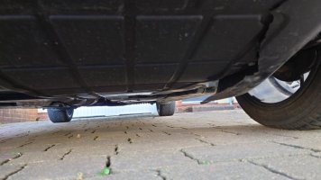

My van is only a few months old. I'm running 20 inch MOMO revenge wheels with 245/45R20 tyres. It's been lowered about 70 millimeters. I did my research, including extensively on here and speaking with recognised experts from this forum, and thought all should be fine.
On full right lock the left tyre bit into the undertray and pulled it down until it snapped where the bolt is. The bolt is fine, just the left side of the undertray is now snapped.

It's a T30. It would be great to get a view on the original question about the end points (a few comments ago). I'm confident the lowering isn't the issue as was done by an industry legend. Will post a photo of the wheel in the wheel arch.
