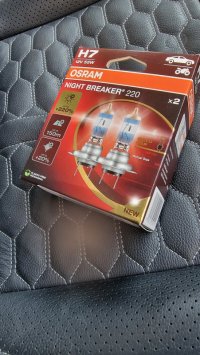

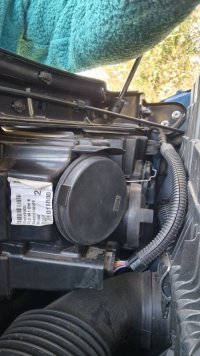

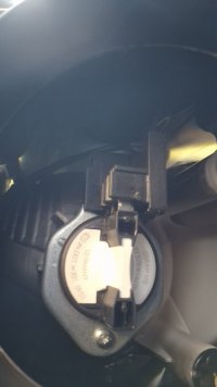

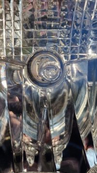

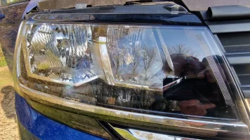

I know folks are probably sick of posts regarding this but why is there such confusion and misinformation around regarding Halogen bulb types. I have a 2024 T6.1 Highline T32 Hil1000009173.jpglside camper, and I have already swapped out the original dip beam H7's for some Osram 220 Nightbreakers without any issue. Yesterday I went to replace the main beam bulbs as well again for the Nightbreakers, the manual says they are H7's so I thought, no problem. The plug connectors are slightly tight to prise off so not wanting to damage anything I called my local VW garage and asked if they would fit them for me, they said yes no problem. After dropping it in the service engineer said I the wrong H7 bulbs, and anyway they didn't recommend fitting them as they might cause dash warnings etc. Most comments I've read say it should be a straight plug in no problem, so I'm reet confused. I've added a few pics, can anyone shed any light, pun intended.
I thought the main beam/DRL’s in the standard lights are a H15 bulb? Only the dipped lights that you’ve already swapped out are H7’s.
