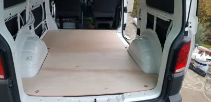

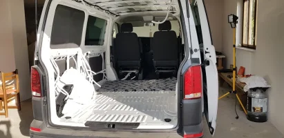

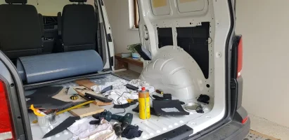

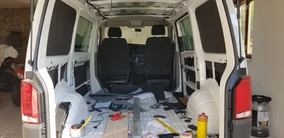

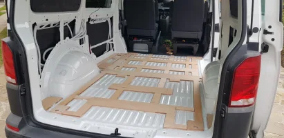

Welcome to the club! I was looking at your photos and noticed a side table with a plant pot in the background? Either you've got a posh garage, or the Mrs is going to be really p*ssed off when she comes home to find you've parked your 'project' in the lounge!!!

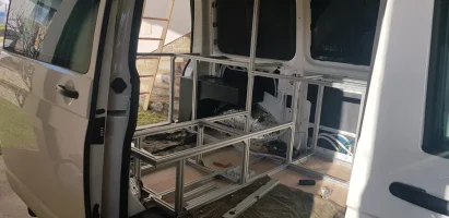

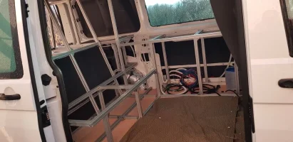

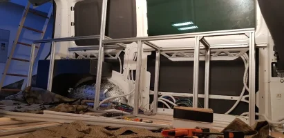

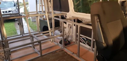

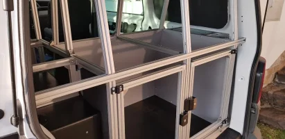

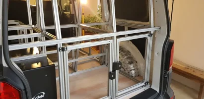

You're bringing this to another level. Very impressed! How does the weight compare to conventional timber cabinets?...and "work in progress" of extruded alu frame in 3D viewer
3Dview on sketchfab.com

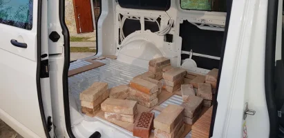

Estimated weight of extruded alu frame is ~36kg (~45m).You're bringing this to another level. Very impressed! How does the weight compare to conventional timber cabinets?

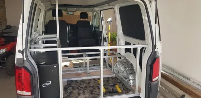

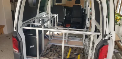

Nice work, looks good. Just a thought on the extruded aluminium frame. Maybe you should introduce a break in the solid line between the rear door and the drivers seat?...and "work in progress" of extruded alu frame in 3D viewer
Great suggestion!Nice work, looks good. Just a thought on the extruded aluminium frame. Maybe you should introduce a break in the solid line between the rear door and the drivers seat?
If you had a rear end crash that long frame member 'might' get pushed straight forward into the space occupied by the drivers seat.
Just a thought.

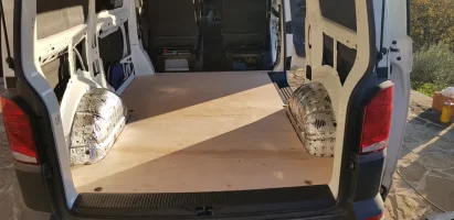

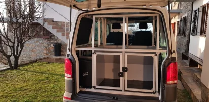

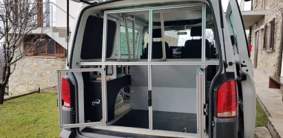

Hey, did you produce these 3D models? If so what program did you use? I want to draw up some racking for my van to make it before the van comes but can’t find any good dimensions.I'm thinking about building a frame for cabinets, dog kennel and bench from extruded aluminium profiles. 30x30mm profiles are lightweight and strong.
extruded alu frame / plywood furniture
View attachment 75258View attachment 75259
View attachment 75260View attachment 75261
View attachment 75262View attachment 75263
