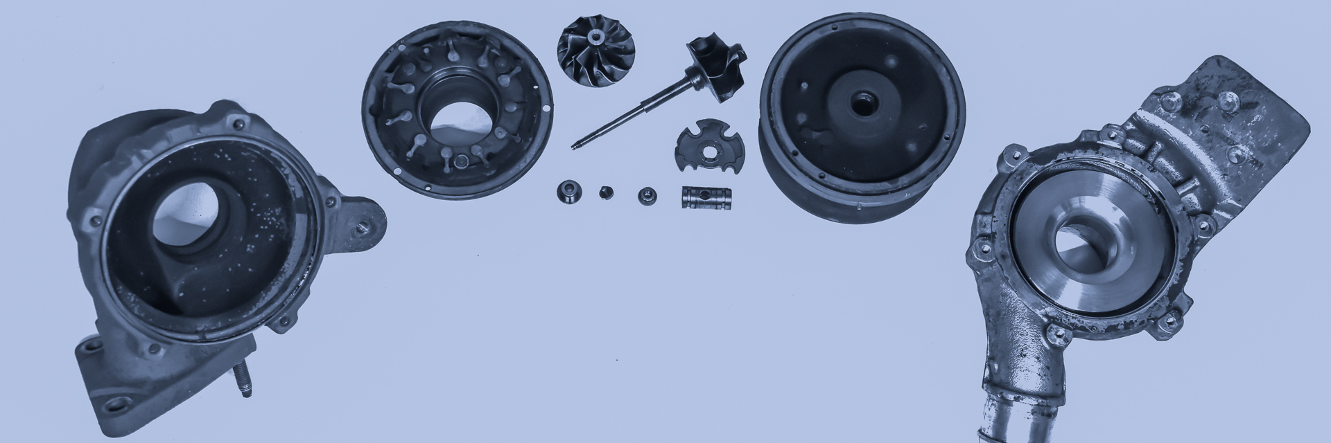

That number brings up this at 2K - Darkside Developments
edit - its not in stock
