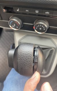

I recently purchased a new second hand VW Transporter T6.1 SWB Edition from 2021 with 11400 km on it. However, I recently discovered a hidden defect with the auto/DSG knob during my first ride, and I'm seeking advice from the community on how to address it.
Upon closer inspection, I noticed that the right hand side cover of the knob was already broken (according to official dealership who deny a warranty claim), but it was not visible during a short test drive before my purchase. The defect was not apparent until I embarked on my initial ride. I have attached a picture to illustrate the issue.

Not a great start! What a S show by the seller…
If it was me I would remove the gerbox stick and have a look. It seems an easy repair.
On the Tube search for VW T6 gearshift knob replacement.
Perhaps take the opportunity to upgrade the knob? The standard knob is fugly and shouldn't be fitted to any vehicle costing more £3.70. :(

Thanks for the advice, judging by the quote from the dealership probably the only one worth trying (they charge a whopping 600!!! euros ). Still don’t really understand the warranty rules but who does anyway…
I will definitely take it into consideration once I have some more financial air as I just bought my precious van as these babies don’t come cheap if you work with OEM parts
