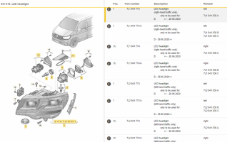

I just double checked to be safe and they do list different versions for lhd and rhd so there must be some difference
