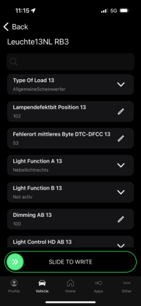

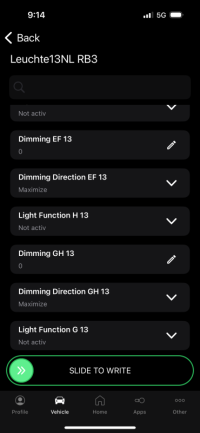

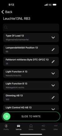

Hi mmi, I have tried using ODD11 to make these changes, where you have "35 and 66" I am unable to change these, instead I ger an error message.
Any suggestions?
Any suggestions?
What's the error message? Did you use Security access to initiate the session? Bonnet open? Does the BCM "see" the light switch (in OBD11 "live data")?
Hi mmi,
I am a new user, sorry if I ask stupid questions,
I did not have the bonnet open, Do I need to?
What is Security access?
I am not sure if the BCM does see the light switch, I did go into live data, selected Fog light but not sure of what I should be seeing.
Have tried again, come up with writing adaptation, several hours later it was still displaying writing adaptation so pulled the device.
The error message was something like adaptation not available.
I have fitted what should be a compatible genuine VW light switch, 5G0 941 431 BD, the plug is pre populated at pin 9.
Vehicle is a T6.1 Multivan, built late 2023.
The first screenshots are of the original settings.
Last shot is after several hours.
Cheers.
I have inserted the light cables to pins 40 and 3 in the center BCM connector.
I'm fairly confident that in year T6.1 2023 Multivan coding/adaptation alterations are locked by bonnet latch and PIN/SA code (Security Access) (which most likely is 31347)
You should see the a change in the live data when the switch is operated - something like not-operated (when at position off), operated (when at fog light position).
Below a snippet from VCDS output (in OBD11 it's similar, e.g. as in post#26 above)
Welcome to the Forum. There is no such a thing as a stupid question
I would guess the OBD11 was stuck as the controller refused to accept the adaptation. A write into the controller takes just a fraction of a second.
Hi mmi,
After following your suggestions I have had some success, after several attempts the adaptations are complete.
The cornering light function is working correctly.
The front fog light switch comes up as not coded/not installed. It is a used switch, 5G0 941 431 BD that I have used, so could be faulty!
I have done a load test which was successful.
Thanks for your help,
I now have to work out the switch issue.
Cheers,
