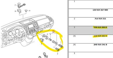

Hello everyone!
1J0919309B - the park which doesn't operate is.
Please advise where can I fund a fuse box for coin tray 12v socket.
What is the number of this fuse in the box?
How and what to remove to reach it?
Thanks in advance.
P.S. Unfortunately I registered quite recently so I don't have an access to the schemes and/or diagrams for that model.

I think you missed the bit in the thread title that says T61. I don't know if they are the same or different though.
Doh! yes I missed that, most of the sockets are in fuse box H under the seat on a T6.1 and the USB sockets are in the Dash fuse box location 15.
