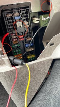

The simplest fix would be to pull out the little cubby hole with the 12v socket by the gear lever - it just pulls out (it’s stiff and may need a little persuasion with a trim tool). You could then disconnect the plug to the 12v socket and replace the leads to connect the positive into a spare fuse slot by the gear lever and the negative to one of the screws just above the fuse bank. The positive could be ignition switched by using the upper central row of fuses and either a single or double breakout fuse. Examples below. Not a complex fix but probably a bit awkward if you are travelling and haven’t got tools!
Pic shows double breakout fuse in ignition switched central row (middle circle). Negative connection is screw (right circle) and location of possible 12v socket fuse (left circle).

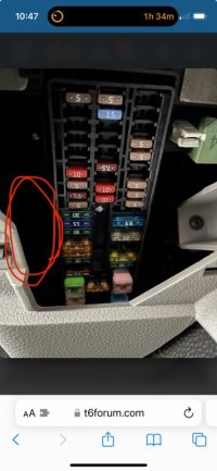

I’ve attached a pic of my fuse box as reference
Any suggestions?
Is there a single fuse in the dark area to the left (circled red below)? My 2018 Trendline has the fuse for the cig lighter there.

Nothing in that space, and I’ve tried four different sockets, they work in the front dash output but not the top one..
