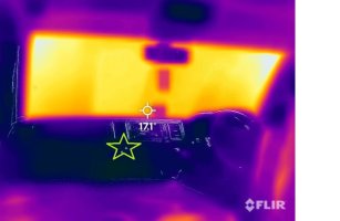

Have you tried directing the a/c to the side vents until it warms up? You could have cold a/c air cooling the windscreen thats trying to heat up. Condensation is always going to take longer to evaporate, you can get dehumidifier’s that sit on the dashboard, might be worth a try?
I did wonder about that. I suppose it may be counter productive blasting cold air onto a heated screen :whistle: Having never had a heated windscreen before, I was interested to know how others use them. As I said, the manual is as useful as a chocolate teapot.
With a heavy frost my windscreen takes probably between 1 - 2 minutes to completely defrost, I’ve not had an issue with condensation on the inside. Given the choice from VW, I think I would rather have had a chocolate teapot than the manual, clear as mud…
