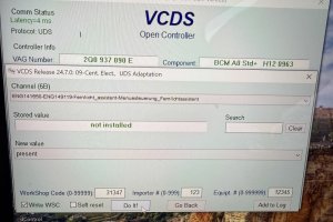

Hi , I’ve fitted high beam assist mirror with camera in to my vw t6.1 and wondered if anyone knew the coding procedure with vcds please , I tried following the t6 version but the options I need are not there , central electronics , adaptions channel 53 and 54.
I know someone got it working on here but they don’t say how they coded it etc
Thank you

how would i do that please, im just new to this i only want my hba switched on nothing else
as @mmi requested, post your scan and adaptions before you start changing anything!
The Auto-Scan and adaptation map show how the van is configured - as often the coding depends what else is onboard - e.g. headlight type, dashboard. All the electrics are controlled via the BCM adaptations also the HBA.
The sccan and the map will also serve as a backup in case coding attempt messes something up.
VCDS​
Just click Start (let VCDS Auto-Detect the van) - save the scan and attach here.
Tick/fill boxes as above and click Go.
VCDS flashes screens for a moment (when finished hit "Done, Go Back") and there should be file adpmap-09... in folder C:\Ross-Tech\VCDS\Logs\....
i cant get it to scan the whole system i get this message, i think i found what i need to enable but it keeps asking for security code, any ideas please
My advice at this moment would be to stop and take a step back, 100% get a full auto scan before making any changes
If it doesn’t work on auto (not sure why it wouldn’t) then try a manual scan, think you only need to select the correct chassis and hit go again
If you are still struggling to get a scan then try the Ross tech forums and/or support channels as they should be able to help you
Are you using a genuine registered interface ?
I tried a manual scan as well and it won’t do it , it does an auto scan no problem on my caddy 20 plate , and my mates Audi q3 it’s just this t6.1 it’s having trouble with , not genuine no
It may be better to ask for VCDS help in your location, and get someone with a genuine product to do the coding and scan for you
Ok I’ve managed to turn it on but getting an error now for light assist , I think I have the incorrect mirror for the van possibly
