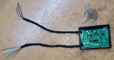

I just got the same steering wheel but also with DSG paddles and touch controller (from 2023 POLO). My existing airbag fits if I remove the touch sensor controller.
I've read countless threads on retrofitting cruise control to a T6 and Polo MSFW was suggested, but I guess most of the work on this was done in 2020 before the MQB made its' way to Polo...
Anyway, I assume my two options are:
- Get compatible MFSW buttons with cruise control and DSG paddles connectors (I have DSG so would like these to work). Any idea on the correct part number?
- Get the MQB-PQ converter, I only found one from Greece Pardon our interruption..., is there a UK source for these? I'm happy to solder and modify, I have lots of soldering experience.
These are made by Evangelis and his brother.
I highly recommend their products.
Developed to the highest standards including full VCDS tweaking.

Where can you get that adapter? It still needs coding with it?
