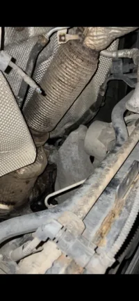

Long overdue update on mine. As well as replacing the ECU ( no reason given by VW ) and the oil sensor, it turned out to be a wiring loom, which was fixed.
Anyone know if there’s a fuse for this sensor? I’ve repaired the break but the fault still won’t clear.. hoping the sensor hasn’t actually failed :(
