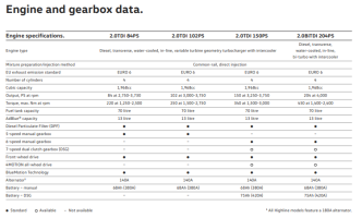

Standard Alternator is 140A.
uprated and HIGHLINE models get 180A.
as per original sales brochure.
