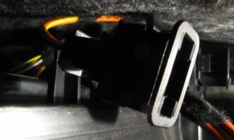

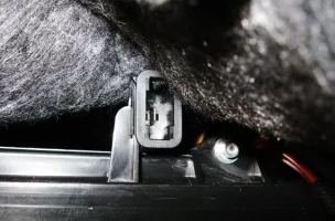

I'm looking for the part number of the female side for this 1-pin connector.
The dealer here does not have any documentation suitable to find it!
The connector is called "T1ar, behind glove compartment" in circuit diagrams, and really - I found it there. See pictures. I need the matching female connector.
It is the line for speed 2 of the fresh air blower, needed for parking heater retrofit/upgrade in a car with manual or no A/C.

The part number will be stamped on that connector, getting that will be the start
If you have that part number then etka will give you the mating connector or failing that just google it and you can normally find the other half
You're right... had to get an endoscope cam first...
Solution for anyone searching:
male, mounted in car: 1J0 972 761
1J0972761
female, new line: 1J0 972 751
1J0972751
Contact is Standard Power Timer (probably)
