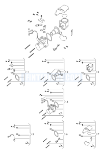

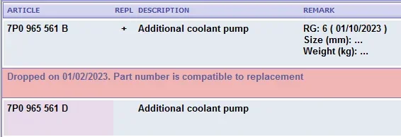

Anyways, the most sold replacement parts:
Temperature sensor - 5Q0898047​
Combustion chamber - 7E0 898 919​
Additional coolant pump - 7P0 965 561 D (not a part of the heater itself)​
Well, before purchasing parts separately probably worth to check what's the price of a complete heater - especially if you decide to go for the Combustion blower (=fairly expensive)
Pictures & part numbers from the website below:
IFInterface > Free Services > CarProg2 > from pull-down menu select the vehicle (TR), MODEL YEAR, under RESTRICTIONS double-click on chassis (7H) > main group (8) > picture, e.g. for the heater 819-070, 819-075.

But my question is, was this specific fault situation ever solved?
Yes.The final cure was the temperature sensor. The coolant pump was replaced first but didn't cure it completely. The fault happened only once in 10-20 startups.
