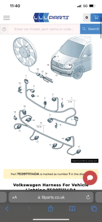

Evening gents need a little help with a connector on the front of my van, the cable was cut during a bump and I can’t figure out where it goes. I need to know where item 5 plugs into ? I’ve attached pics

That is a coupling point near the horn, behind the bumper, driver side behind the fog light area. That will carry the CAN info for a few things including your front radar.
I thought the orange wires were CAN which explains the faults I am getting I’ll have a look for a cut cable near the horn as I couldn’t find one anywhere else
