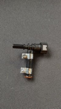

Surely you have the tee that you are fitting so that you can see? One each side like on this tee that you are putting on!

Yes, I have the 'T', and as you can see, it's very much like the one you picture. That is clearly released by a 'button,' (or 2).

You are pushing the fitting home first and pushing the buttons aren't you? You have to push it in against the seal to allow the buttons to disconnect.
I don't like the look of those joining rubbers that you have there. I use and supply Gates Barricade R14 hosing for the kits that I supply. 100% ethanol proof and bio-diesel proof. I can't see any markings on those and they appear to be nitrile ones which I have seen split very easily.

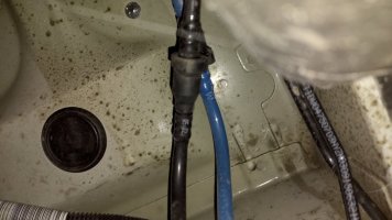

Put up a picture of the connector that you are trying to disconnect, maybe you have a non-standard fitting.
This is the only picture I can get for now, I will get better ones once the weather improves, and I can get under the van.
The return connector (hidden at the top), is the same as the black feed line.
The picture is poor, the area arrowed is a flat 'side' of the connector, that forms a square with rounded corners.

My sincere apologies. The area you highlighted was indeed a single very small 'button' that released the connectors.
It was dirty, and I couldn't see one on the return line.
It turns out the return line release button was on top, hidden from view.
