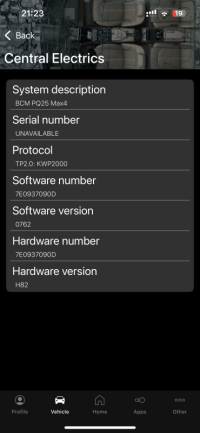

Can you post your BCM details, address 09?
Is it revision C or D ?
You could relearn your key with OBDELEVEN but your BCM would need to be downgraded (ODIS or VCP flashing).
