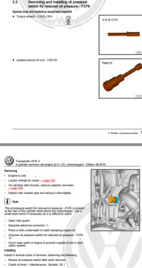

Can anyone point me in the right direction to locate the low pressure sensor on a 2016 T6? I'm having a yellow low oil pressure warning light flashing and going to replace the sensor.
Should be the reason as I'd just had a oil service 3 wks ago.
What engine? Upload a photo of your build label from under the steering column..
engine CXEB CXFA CXGA CXGB CXHA CXGC CXHB

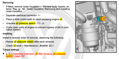

My engine is a CXHA and I still can't locate it from that diagram instruction I've taken some pictures. Could you circle the area?
i Note
The oil pressure switch for reduced oil pressure - F378- is located
at the rear of the cylinder head above the turbocharger. Use a
small hand mirror if necessary as it is difficult to reach.
