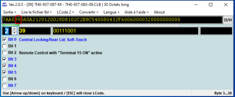

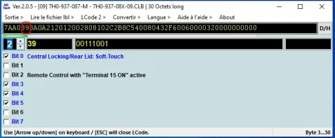

On my side I have this as MrG
As I can't see View attachment 266119I need to change manually the arrowed 0 ( 6th position from the left) by a 1 ?

Hello Guys,
Quick question just to be sure I've understood correctly.
Thanks in advances for your help !
Nico

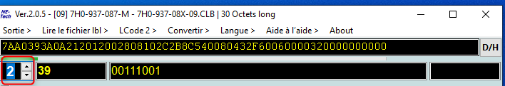

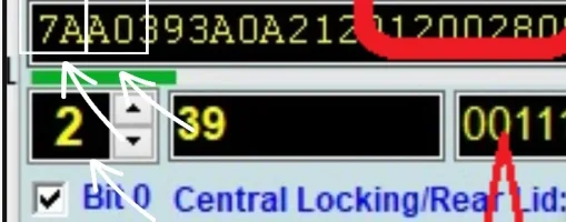

I don't have it in front of me and was a while ago but..... No.
Follow Robert's comment exactly and all will make sense. Don't use the arrows to select Byte 01 & 02
In the coding of your module 09 click directly on the BYTE 01 and 02 and then tick your bits as required.

Hello Guys,
Nico

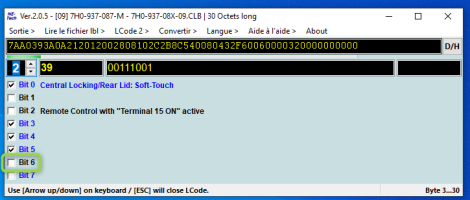

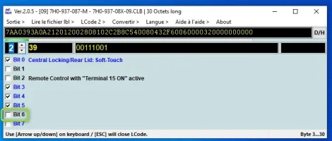

No. The bits are numbered as 7,6,5,4,3,2,1,0, the 0 being the rightmost.
Perhaps the easiest way would be to use the LCode2 tab to open up all the tickboxes, and simply tick the bit 6 there.

You could also just type "2" or click on Byte 1 or 2.

Hi everyone,
Thank you so much for your time and help—it’s been incredibly useful!

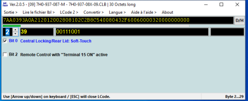

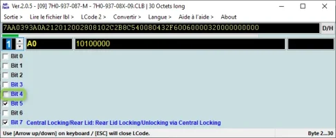

I’ve realized my mistake. Instead of clicking directly on the long line, I clicked here
and then… nothing happened.
Thanks to your guidance, I clicked in the correct spot this time, and now we can clearly see the difference.
I’ve made the necessary adjustments, and after a few moments…
Good news! Everything is working as expected now!
Thank you all again for your support!
