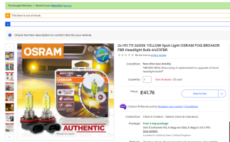

I bought & fitted these:
Yellow is not to everyone's taste, but certainly a lot better colour than bright white to break through the mist when driving on a wet & foggy A66 road into Cumbria. :thumbsup:
Cornering function works fine, they start to fade out slightly then just turn off. No strobing or odd things happen.
