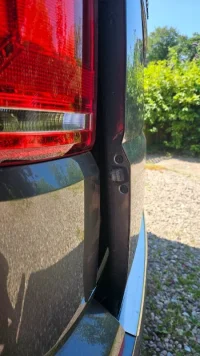

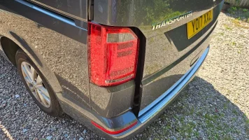

Tailgate Stand-Off Latch
We've never had any rain when using our stand off but I would be surprised if water did not get if using it when it comes down. Bottom line is there's a gap and if there's a gap, water will always find it eventually.

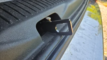

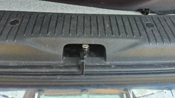

For anybody struggling to align there standoff bracket, this method is quick and works every time:
Here’s a tip for using a Brandup Airsafe (tailgate ventilation bar). I’ve been using it for a while now and it’s a PITA to align with the tailgate lock, best done with two people with one inside positioning the bar and one outside to close the tailgate.
Obviously this only works if;
1. There are two people.
2. There is enough access to reach the area of the tailgate lock.
In order to make this an outside only, one person job I have attached a small cable tie base (superglued) to the tailgate lock.
Anything similar will work.
Next with the Brandup Airsafe bar in place on the van I placed a loop of strong but thin cord around the end of the bar that will engage in the lock. In my case I used 60lb fishing shock leader as it is strong and will not fray.
Both loose cord ends were then passed through the same eye on the cable tie base and tensioned.
Next the tailgate is slowly closed with one arm while tensioning the cord with the other.
This action lifts and aligns the Brandup Airsafe bar perfectly with the lock.
With the lock is engaged one end of the cord can be pulled to remove the cord from the lock.
