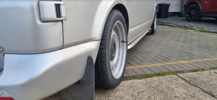

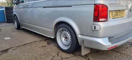

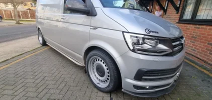

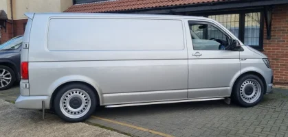

Are they 8.5 and 9.5J?
8 and 8.5, std duchy sizesAre they 8.5 and 9.5J?
I thought his standard size was 8.5f 9.0r?8 and 8.5, std duchy sizes![]()
Ah yeah maybe its that then?I thought his standard size was 8.5f 9.0r?

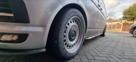

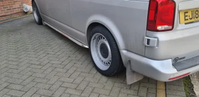

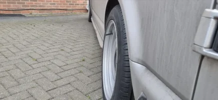

What load rating on those tyres?Something most won’t want to run!! 225/40 front and 235/40 rear
Don’t think he was recommending them saying “something most won’t want to run” banded steels aren’t load rated either if the insurance wanted to be real knobs about it .What load rating on those tyres?
I can only find 88's and 92's on the 225/40's and 91's and 95's on the 235/40 sizes.
A T28 needs 100 rated tyres as a legal minimum requirement. T30 is 101, T32 is 103.
Anything less would be a MoT fail and leave you open to all sorts of sh!t if you were to be involved in an accident.
Might I suggest not recommending those tyre sizes unless you can give specific load rated tyres that match the requirements?
It certainly wasn’t a recommendation. Wrote it fast, so my bad. I was just sharing what tyres were run on the banded steels that low. If you agree or not that was what was being run. I don’t suggest anyone runs those tyres.What load rating on those tyres?
Agree, works with the commercial front end.Might only be 16s @Ljeezy but does look good
