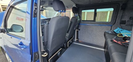

Team Blue
No Solar? Or is that on the future additions list?
I'm very #teamblue :cool:

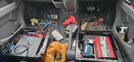

I also have 2x 240v Victron chargers, one 15a for EHU in the van and a separate 5a 240v charger.
With a little bit of blue and black...

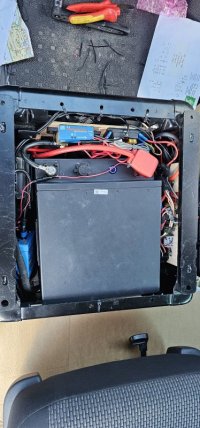

Out of interest what are people doing in regards to holding down these big 230 ah seat base batteries.?
I had some webbing strap around the seat base frame at the back wrapping around the battery...
Though I haven't actually got the web ing fitted at the minute on Ava van.
Most batteries are a tight fit but there is some small movement left right up and down it's going over speed bumps etc.
I don't have a picture but I used some (really handy) velcro strap that attaches to itself, around the battery front to back, then around the back of the seat base and my inverter mount.
Mine is very tight in there, so much that I have to have a strap around around it to lift it out!! 3000+ miles in and I've never heard or felt any issues - there's a tiny but of moment side to side but nothing major. And if I get enough vertical movement to lift it off the van floor then I think I'll have bigger issues! o_O :rofl:
Never really bothered fixing it down. Never felt the need as Paul says its that tight under there it has about an inch in any direction. And I don't Dakar it so not really worried
