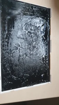

One hint: mine digitizer stopped working but was glued to LCD hard, so removing was not easy. I've used old guitar picks to disassemble but better was... dental floss :D After that, good to have sth hard to first remove glue mechanical, then with isopropanol.

Placed a digitizer over the original, all touch points work however get this 3D rainbow effect when viewing from off angle…
If I lean over and look dead on it’s fine…
It’s a bit distracting!
My head unit started to fail frose and bought digitizier and IT worked touch wice but the left side is so dark its almoust inpossible too see anything, bought a New one but IT is the same anyone have this problem?
Have the pins bedded in nicely on both sides? Handle them gently and give them a wipe with isopropyl alcohol just before they go in
The rainbow effect is due to diffraction scattering - meaning you have a very slight gap or different materials between two layers.
Was pretty certain I’d removed all protective layers… probably gonna have to take it apart again, as it’s distracting
If you do, give the screens a really good clean - they’ll practically adhere to each other that way
I would remove old one... It's really not do hard if you do this gently, and the effect will be faaaaar much better. Also it fits better.
