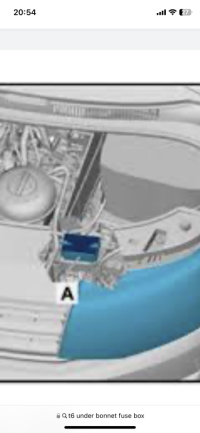

Hi, try the fuses next to battery. Easy to locate abs light be same cause as mine.
Hi nl1965,
Yep that's what it was. There were 4 fuses in a bank next to the batt and obviously it was the last one I checked.
