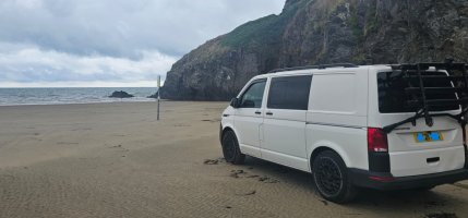

Here are the basics of my build so far:

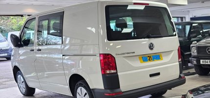

The only van realistically in my price range was an ex-fleet van being sold off. Here are the details:
- Van: £16,000 + VAT
- T6.1, 110ps Startline, 80k miles, full service history with changed timing belt and water pump (1+1 and 2+1) 5-seater Kombi (21 plate).
- Sound deadening and insulation: Stripped out and sound deadened with Dodo mats, then fully insulated with 10mm closed cell and natural hydrophobic insulation for the whole van, including doors, roof, and cab (£400).
- Revo remap: 160ps (£399)
- Inspection and service: With a reliable VW independent garage (£320).
- Fake OVANO: Essentially the same as the original but second-hand from a nearby converter display (£700).
- Dream mattress: (£230).
- Wolfbox G9000: Amazing bit of kit, though challenging to get through the conduit at the rear door (£203).
- 2x Captain swivels: (£180 each).
- Limo tint: Rear and back window (£180).
- Bike rack: VW 4x tailgate (£400) + disassembled and powder-coated (£48).
- Rhino Alloys + BFG Trails: Almost new (£800).
- Roof rails: Black (£65).
- Sounds like a Golf seals: Gift.
