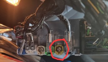

My usb hub is only charging the phone.
Is it possible that I do not have an activated usb port?
What is that picture ?
Looks like the back of the headunit and not the usb hub
The headunit puts 2 data pairs out on the fakra connector and the 0v and 5v are in the iso plug running out the edge of the picture
