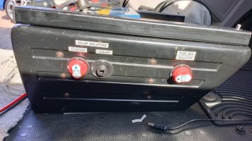

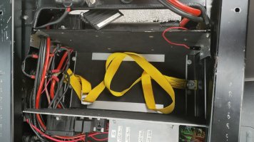

Completed fitting of the new charge controller today, squeezed it in beneath the inverter under the driver's seat and wired it all in. Was a bit of a pain getting it all in but seems to be working OK, now have the option to keep the starter battery topped up throughout the year.

Looks like you have......
Victron mppt.
Victron inverter.
Redarc DC-DC.
What's the operation modes?
I'm assuming it's all charging the leasure battery all the time.... How do you switch over to charging the starter battery.?
The victron smart solar is set to AGM for the starter battery, the Redarc is set to Lithium for the leisure battery. By moving the red key from one isolator to the other the solar panel input from the roof mounted panel can be diverted to either charge controller but not both at the same time (you'd have to insert another key to do that which would not be recommended)
The third isolator is to disconnect the fuse box feed so everything (except the fridge which is permanently live) can be turned off in one go (so no drain from usb converters or diesel heater controllers that are fed off the leisure battery)

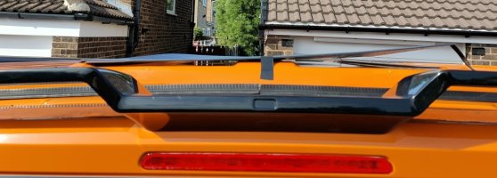

Just pulled the old solar panel off and hoisted the new one into place and I find the new panel has a curve to it that is in the wrong direction to what it needs.
Does anyone think if I leave it up there for the night that it might relax and fit a bit better? It may put more pressure on it than is desirable to go ahead and glue it down like it is.
Yeh.... No worries.
The sun and heat will relax the substrate... And it will drop to the curve of the van.
Nothing to. Worrie about
