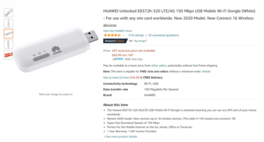

for WIFI in the van i use a USB 4G WIFI Dongle . . . like this one.
(i did have it in the glovebox, but have now installed in in roof lining by roof lights - works fine with reception etc)

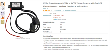

i had it plugged into 12v USB charger .at first . . like this Anker one i had.
but now I've hard wired it with a 12v / USB power converter.
at first i had it running from the IGN only . . . . so it was only on when driving etc . . .
but now I've moved it over to a Leisure battery feed . . . so its on 24/7
i can now hook up the RING camera and BlackVudash cam to the cloud . . . as well as conect the Victron kit to the cloud.

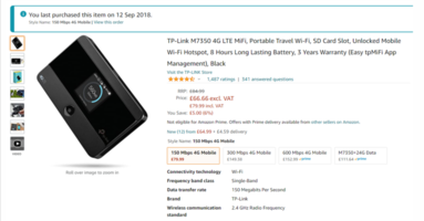

fwiw I've got one of these too . . .
similar thing, but has a built in battery and will last most of the day.
so if in the van, connect it to a USB feed thats on the IGN ,. . . . then when engine is off this unit will keep the wifi going on its own battery power . . . (for 1-2day depending on use and signal strength)
when the van is restarted the internal battery recharges . . via USB
we have it on holiday etc so the kids can share the wifi and internet . . . i just drop it into my ruck sack . .
keeps the Yoofs happy =]

Hey @Dellmassive
How did you hardware the TP link M3750 mobile hotspot device into your van? Did you use the 12V usb power converter you mention?
I already had Ignition USB.
And 24/7 USB.
So I just plugged into that.
And here.
Currently I have the Huawei plugged in above the centre top light unit on the headlining...
It's connected to the usb from the leisure battery.
So now 24/7.

The TPlink unit I take with me mobile, when I'm away.
And just get a local data sim.....
Using it now as it goes.....

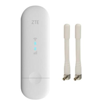

@Dellmassive I am wondering it a dongle with external aerials will give a stronger signal, and not lose signal when the 4G signal is weak if it has external antennae like this:
@Skyliner33
yes . . . i run two units with external aerials.
defo works better in low 4G areas . . . . ie costal towns.
i normally use these on holiday with the family on some Haven caravan site somewhere
i stick the antenna high on a window for the 4G, then share the wifi locally.
1st unit: Huawei E5785lh-22c
second unit: Huawei E5787ph-67a (grey import / colour screen)
then a TS9 patch antenna . . .
similar to this . .
but the cheap antennas are not brilliant . . .
you should get better reception.
you can get better ones. . . ie

Thanks, I might give that one in the eBay link I posted a punt then. £200 on those Huawei ones is a bit expensive when Im just seeing how they work and if I will use it much
