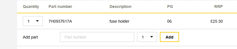

So yesterday I decided to check the fuses for the heated screen as one half stopped working a couple of weeks ago. Quickly found the fuse, and it had melted! I noticed that the the fuse holder was very dirty/corroded and wobbly, and that the box cover hadn't been closed properly by the last person in there. For info, I've had the van (2018 150 DSG 49k miles) since April 2022 and have never had cause to go into this fuse box before. Realised that the holder will need replacing but decided that it was a job for another day. Closed everything up and then when I came to start the van had it loads of errors, and the van won't start! The display tells me to select park, which it already is, and press the brake, which I am. Stereo said something about park assist as well.

That front fuse box looks terrible. And will need replacing id imagine.
Looks like salt water got in there?
Yeah it's really battered. Several bits broken off it, and the retainer clip/spacer that stops it rattling about was missing too. Not sure what happened exactly, but yes it does look like salt corrosion. I will replace the fuse holder at some point, but right now I'm trying to just get the damn thing running again! Some of this wiring is really dodgy. Looks like a cowboy has had his hands on it in the past.

The load side cable of each fuse slot would be ok to repair as the corroded crimp can be cut off and replaced
The fun bit is going to be the supply rail that runs down the feed side of the fuse slots, its part of the wiring loom and could be tricky
IIRC the rail does clip in and out of the fusebox so i guess you could buy a 2nd hand loom or fusebox and cut/join the rail to your existing feed cable if needs be, i guess you wont know the extent until you get it out and have a proper look ??

I do still need to replace the fuse holder at some point to sort the heated screen fuse, but that can wait to another day.
