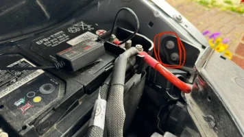

Hi all this is my battery, the little brown cable is this on the right terminal as it looks like it should go to the positive?
Many thanks
Just connect the brown cables to the bodywork to pick up their negative connection and so that the vans battery shunt can accurately tell the ECU what state the starter battery is in.

For the entire van to lose power and things reset it has to be one of the main connections
I would start with the battery terminals then check the main body earth down beside the battery (follow the fat negative cable from the battery) as that has been known to come loose and give a bad connection
