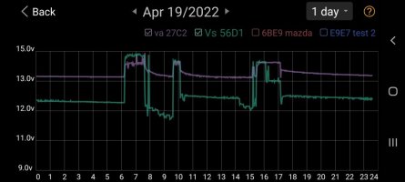

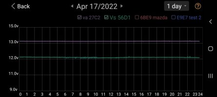

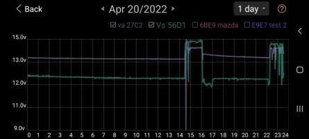

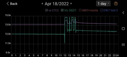

Here is my BM2 plots for the last few days....
Va - van aux.
Vs - van starter
AMT12-2 . Not installed ATM. Still testing roamer 230sb battery.
So this is normal starter battery behaviour for my van.
Va - van aux.
Vs - van starter
View attachment 153901View attachment 153902View attachment 153903View attachment 153904
By way of comparison, I just thought I'd have a look at your data and it highlighted that my starter battery is discharging way too fast!
Then I realised that the data is across 24 hours and I initially thought it was days! (I thought you'd not used you van first 2 weeks and seen minuscule depletion in voltage! :)
Sure..

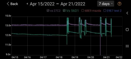

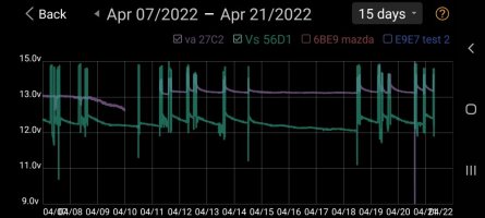

Here is same data for 7 and 15 day views.

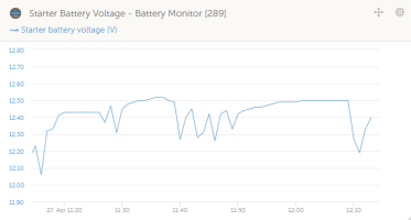

My relationship with the Ablemail AMT-12 was off to a rocky start as it would only charge with my starter battery when the lithium leisure bank was above 13.5V and the starter under 12.4V. This is well discussed by @Dellmassive on the following topic - BM2 update
(To be fair this was detailed in the instructions that came with the unit, but the instructions also stated that for a LifePo4 leisure and an AGM starter use profile 3 or 7.)
I originally plumped for profile 3 and found that the threshold for the leisure battery was simply too low. Today I removed the seat (again) to changed to setting 4 and played around by draining the battery as much as possible and seeing how the AMT-12 got on. After a couple of hours I decided I'd try out setting 8 which is the same as 4, but with a "Higher power setting". (This was largely inspired by @Skyliner33 on post #24 of the BM2 update topic. Thanks @Skyliner33!)
I am yet to determine what this higher power setting means, but i have more capacity in my leisure battery than I need and so I thought see how I get on.
It was a bit difficult to test when the starter battery was in good health as it maintained 12.4 volts prior to being unlocked. Unlocking caused the voltage to fall but the below graph clearly shows the trickle charger quickly doing its thing to recover the voltage back to 12.4 Volts (Just before 11:40 and again after 12:10):
All good so far. Now need to see how things go when the vehicle is left to rest.
