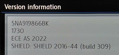

I just bought a 2019 Multivan T6. I am having trouble updating Discover Media. I tell you my problem:
I have tried DiscoverCare, but in the installation process I receive an error that the card does not have enough space. Looking for information, I have seen your tutorial.
I will have to do it manually, but I have a question. When viewing the attached photos, will I have to install Europa1 (DiscoverMedia2_EU1_1410_V12)? Can I install Europa AS (DiscoverMedia2_EU_AS_1430_V12)?

My English is not very good and I have had to use the translator. And without realizing it, I have copied it in Spanish.
I am already manually copying Europa AS (DiscoverMedia2_EU_AS_1430_V12) following your tutorial.
Have if it works for me. I will comment.
