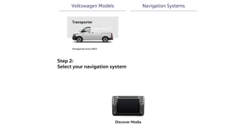

Update files can be found on the official VW infotainment website for direct download
app-connect.volkswagen.com
Visit this site, select the transporter model and then select the discover media unit

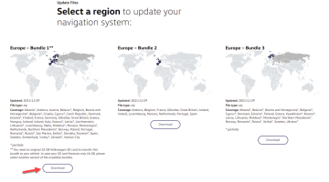

Find Europe bundle 1 and hit the download button
Leave it alone for a while for the download to complete, this will take anywhere from 10 minutes to 10 hours depending on your internet speed
