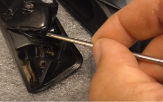

I've just replaced a leaking tailgate door handle and have done a video on YouTube
Basically, the seal around the outer part of the handle comes loose, allowing water into the handle and through into the tailgate.
New handle delivered for £50 and now all sorted

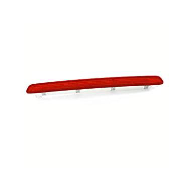

Tail light OEM code 7E0945087F

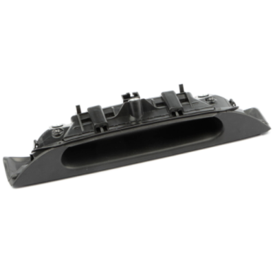

Can you give us the handle code as well please?
If you can supply us with who you bought these from, that would be appreciated also.

Looks like its certainly higher up the tailgate than the water coming through the handle would be.
That was with the tailgate lifted up. I took the little bungs from the bottom and it came out of there as well. The handle doesn’t look great TBH

I’ve got water in my tailgate, stripped out the carpet and insulation. I think it’s coming from the light but can’t be 100% sure. So I’m going to change that first. What cost is the light / handle?
