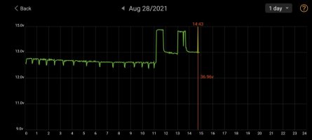

Weird voltage spikes with Solar and CTEK D250se
I've just had another spike, this time with no solar and no load so I guess it must be the monitor/app! I've just put a new monitor on another car so will see what happens with that one now too.

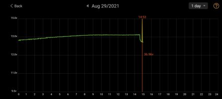

So it seems my new monitor on a different car does the same thing, again when I open the app, a spike at 36.96v with no load and no charger connected

Yeh ..
Nothing to worry about.... They will fix it going into the next version update.
It night help for any1 to do a feedback report via the App... Just showing a screenshot and brief description of the blips.
I've done this also .... But more people that add feedback the quicker it will get fixed.
