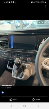

Hi mate its the standard one it does everything but doesn't have satnav, think there are 2 above this from vw?
Completely different as your one has all the connections behind the screen
the units above have a separate module behind the dash where the connections are, then A cable runs from the module to the screen.. so not a simple swap over
But do you think its possible?
Yes I cannot see why not, but trying to obtain a unit may prove costly
